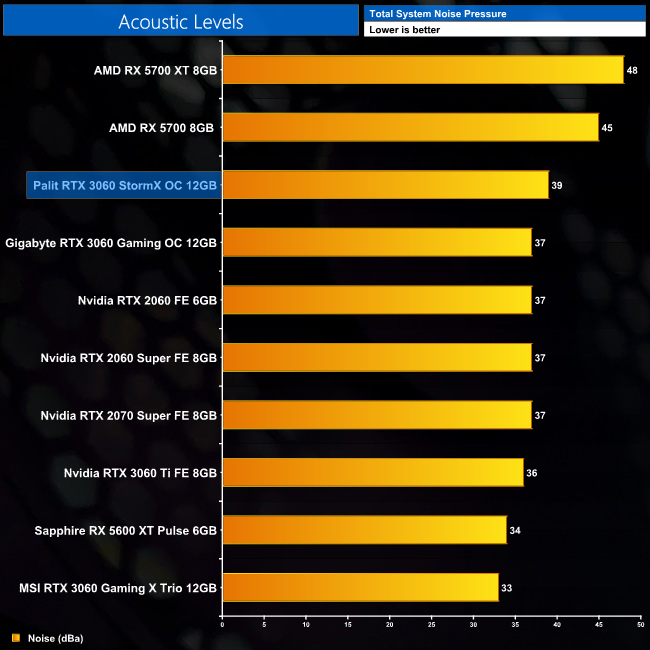

Ta CG est testé sur ce site , il l'indique à 80° en gaming et comme indiqué plus haut, la différence est énorme niveau bruit , 39db pour la Palit et 33db pour la MSI Gaming.
https://www.kitguru.net/components/ [...] review/21/
Default fan behaviour for the single 100mm on the StormX OC sees it spins up to 54%, or 1570rpm, with a noise reading of 39dBa. This certainly isn’t nearly as loud as something like the RX 5700, but it was just about audible over our system’s case fans while gaming. I still wouldn’t class it as a loud card, but is is audible.
https://i.postimg.cc/sfTRSC4C/acoustics-1.png
