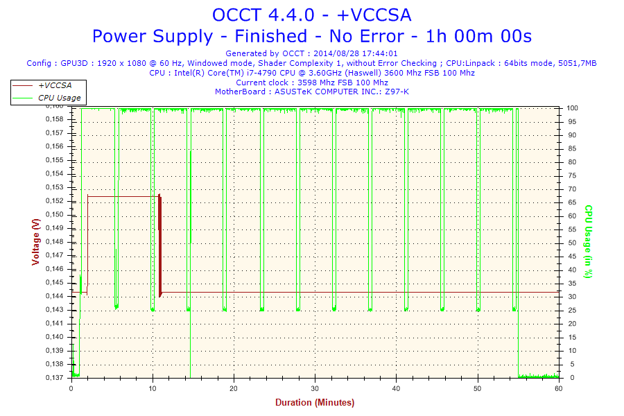

Vous l'aurez compris je suis un peu largué. Voici toutefois le résultat de mon test d'une heure en mode "power supply"/cores logiques désactivés, dites moi si vous voyez de l'anormal là-dedans parce que je ne saurais dire...
https://lh5.googleusercontent.com/-dqm50wGNAGg/U__Z03YsSfI/AAAAAAAABlM/o_smBNKfjAA/w1125-h750-no/2014-08-28-17h44-CpuUsage-CPU%2BUsage.png
https://lh3.googleusercontent.com/-9Rdc8jrCNgY/U__Z0yY2f7I/AAAAAAAABk4/Ko7VCIdm9TA/w1125-h750-no/2014-08-28-17h44-FPS-FPS.png
https://lh6.googleusercontent.com/-Cj4dpWXmJ2I/U__Z8F1-ZoI/AAAAAAAABmg/v38AO-KXiZk/w1125-h750-no/2014-08-28-17h44-Frequency-Bus.png
https://lh6.googleusercontent.com/-CR357crhQfk/U__Z1WOuJ2I/AAAAAAAABlA/vBLUh7L08PQ/w1125-h750-no/2014-08-28-17h44-Frequency-CPU%2B%230.png
https://lh6.googleusercontent.com/-4y4uuaHxYCI/U__Z1l3W4uI/AAAAAAAABls/jJKB-sUZiMc/w1125-h750-no/2014-08-28-17h44-Memory%2BUsage-Memory%2BUsed.png
https://lh5.googleusercontent.com/-zAsuGtvg2L0/U__Z2_fxCkI/AAAAAAAABlU/4jp6t1eFPDI/w1125-h750-no/2014-08-28-17h44-Temperature-Core%2B%230.png
https://lh3.googleusercontent.com/-zzjVUVC-9nE/U__Z3c6HimI/AAAAAAAABlc/t2Unn5SyWhs/w1125-h750-no/2014-08-28-17h44-Temperature-Core%2B%231.png
https://lh3.googleusercontent.com/-AAO3Jn4oCXU/U__Z4B7uOXI/AAAAAAAABmk/FH5bpyqvZhE/w1125-h750-no/2014-08-28-17h44-Temperature-Core%2B%232.png
https://lh5.googleusercontent.com/-iYXCZGPr_t0/U__Z4h1sGKI/AAAAAAAABlw/z_pOLsVLzeQ/w1125-h750-no/2014-08-28-17h44-Temperature-Core%2B%233.png
https://lh3.googleusercontent.com/-s3rqJCQD72M/U__Z1wvWPPI/AAAAAAAABlI/ZpAaTCnVMXg/w1125-h750-no/2014-08-28-17h44-Temperature-CPU.png
https://lh4.googleusercontent.com/-Yh4vRPkAGfs/U__Z5XywOTI/AAAAAAAABmo/yIEvcGTBcNU/w1125-h750-no/2014-08-28-17h44-Voltage-%2B3.3V.png
https://lh4.googleusercontent.com/-grcPG5oYVEQ/U__Z5uQR2QI/AAAAAAAABmA/rVQDSGO2dHo/w1125-h750-no/2014-08-28-17h44-Voltage-%2B5V.png
https://lh5.googleusercontent.com/-yzWO48y8KOU/U__Z5P-Km0I/AAAAAAAABl4/260-EL_JJag/w1125-h750-no/2014-08-28-17h44-Voltage-%2B12V.png
https://lh3.googleusercontent.com/-g664J2H_L88/U__Z6b2dtEI/AAAAAAAABmI/mpHOkr-2AFQ/w1125-h750-no/2014-08-28-17h44-Voltage-%2BVCCSA.png
https://lh4.googleusercontent.com/-M8dqjwawN7o/U__Z60m5KpI/AAAAAAAABmQ/sgP3SMI_2WE/w1125-h750-no/2014-08-28-17h44-Voltage-CPU%2BVCORE.png
https://lh5.googleusercontent.com/-h8SJbkpzjpg/U__Z7cBWB9I/AAAAAAAABmY/MDCHiF2qPDU/w1125-h750-no/2014-08-28-17h44-Voltage-VIN0.png

4) J'ai également installé AI Suite et je viens de vois qu'en 12V je suis descendu pendant quelques secondes à 10.5V, c'est grave docteur ? (quelle est le pourcentage de tolérance en variation d'ailleurs ?)

La marge de tolérance est de 5%, soit entre 11.4V et 12.6V pour le 12V.
C'est à cause de cela que l'anti-surge s'active sur ton alim.
En tout cas ça veut dire qu'elle n'est pas si stable que cela ton alim.
Je passerai au SAV.
