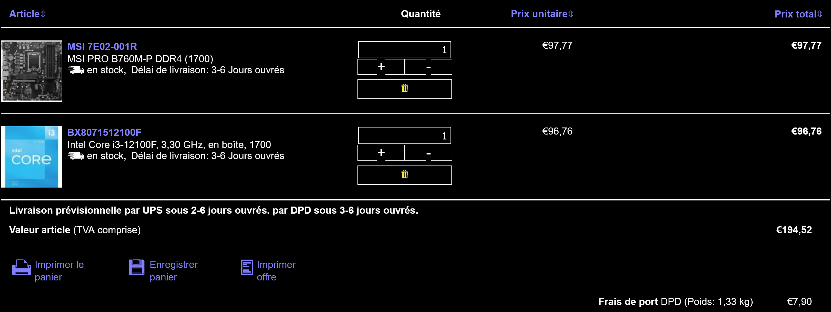

12100F + MSI PRO B760M-P DDR4
https://www.zupimages.net/up/23/29/tfwp.png
