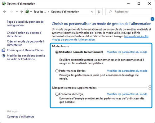

tu as test la/les option alim ? https://kaas.hpcloud.hp.com/PROD/v2 [...] t-pwr-plan
