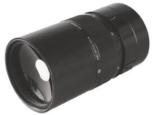

Quelques infos pour vous faire partager mes recherches sur les objectifs à miroir :
Le principe :
Plusieurs modèles :
- MTO 10/1000 : Focale fixe 1000mm , Ouverture fixe 10
- MC Rubinar 5.6/500
- MC Rubinar 8/500
- MC Rubinar 4.5/300
- Konica - Minolta 500mm f/8 AF !
- Samyang 500mm f8 (+ bague T)
- Tamron SP 500mm F/8
Description de certains modèles ici :
Rubinar 5.6/500 : http://m42.povlab.org/lens_detail.php?lid=332
Rubinar 8/500 : http://m42.povlab.org/lens_detail.php?lid=92
MTO 10/1000 : http://m42.povlab.org/lens_detail.php?lid=91
Trouvables sur www.rugift.com ou via eBay ou via un contact sur Photim (Pierre94 ou Piotr) qui vend aussi sur eBay (mais je n'ai pas son pseudo).
Necessistent pour un EOS une bague adaptatrice de type M42.
La mise au point est délicate car se fait manuellement. Trépied quasi indispensable.
Sujet aux turbulences atmosphériques (idem téléscope quoi même si le tube est ici fermé).
Difficilement utilisable pour les sujets en mouvements.
Illustrations :
MTO 10/1000
MC Rubinar 8/500
Examples :

For focusing on things far away (infinity focus is typically things further than 1000 times the focal length - here more than a kilometer) such as the moon you can try using a Hartman mask on a nearby star. Cut a piece of cardboard into a circular mask the diameter of the front of the lens. Then, half way between the perimeter and the center, cut out three holes 120 degrees away from each other. These holes shold be the same diameter as the central obstruction of your lens. With this mask on your lens, point to a bright star. In the viewfinder, you will see that bright star as three stars. As you focus, the parallax will show that the image is focused when your three stars become one. Your lens is then focused for infinity. Tape it down so it doesn't move, and frame your moon. Don't forget to remove the mask before taking pictures! (Done than a thousand times).
Like you read, other things can throw off focus. Mirror flop can come into play. Poor collimation as well. I would strongly discourage trying to collimate a cat lens if you've never done it before. There is an easy test to see if it needs collimation in the first place. Once you've focused your star, back off focus slightly until the star looks like a small disk. This disk will show in effect the shadow of the central obstruction, using the light of the distant star. Any misalignments will appear as the shadow being off-center in the disk. Any imperfections in the shape of the primary mirror will also show as smearing or stretching of the disk itself. Google Airey Disk to find all about it. Collimation, catadioptric would be good key words too.
PS : Je n'ai pas trouvé de topic dédiés et l'info est tellement perdue dans les topics "objectifs pour reflex" que je trouvais sympa d'un avoir un dédié. Si pas charte compliant, merci au modo de locker, je copierais les infos dans le topic idoine
