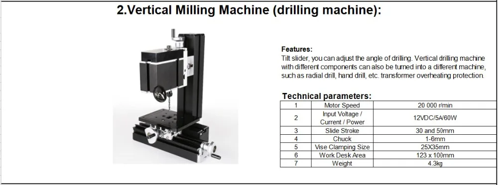

Les outils Tool The First de Shenzhen Zhouyou Intelligent Technology: j'hésite entre geekerie coup de coeur et SFBA:
https://fr.aliexpress.com/item/TZ10 [...] 62101.html
https://ae01.alicdn.com/kf/HTB1tDsWPFXXXXaPXpXXq6xXFXXXO/200442230/HTB1tDsWPFXXXXaPXpXXq6xXFXXXO.jpg?size=121749&height=784&width=1000&hash=025e633cf4c80b870c608557bb236eef
https://ae01.alicdn.com/kf/HTB1UYEFLXXXXXXzXXXXq6xXFXXXF/200442230/HTB1UYEFLXXXXXXzXXXXq6xXFXXXF.jpg?size=76603&height=368&width=1000&hash=cc450827ff3ba48876f805fc8fffd458
https://ae01.alicdn.com/kf/HTB1I_oxLXXXXXXsXpXXq6xXFXXXM/200442230/HTB1I_oxLXXXXXXsXpXXq6xXFXXXM.jpg?size=73957&height=372&width=1000&hash=8e05db17790c22034a9f92f1acb892c6
https://ae01.alicdn.com/kf/HTB1ngwqLXXXXXXFXFXXq6xXFXXXF/200442230/HTB1ngwqLXXXXXXFXFXXq6xXFXXXF.jpg?size=75092&height=355&width=1000&hash=6455d6d56e28978bcdd2079d911b9bc3
https://ae01.alicdn.com/kf/HTB1VfZyLXXXXXXrXpXXq6xXFXXXL/200442230/HTB1VfZyLXXXXXXrXpXXq6xXFXXXL.jpg?size=75931&height=338&width=1000&hash=c5fa3094fb50d7291cf92e84f1484ca6
https://ae01.alicdn.com/kf/HTB1JwwcLXXXXXXsaXXXq6xXFXXXt/200442230/HTB1JwwcLXXXXXXsaXXXq6xXFXXXt.jpg?size=75772&height=406&width=1000&hash=d115db9f7d6bc998947825b382b6ba56
https://ae01.alicdn.com/kf/HTB1ynZdLXXXXXc_XVXXq6xXFXXXn/200442230/HTB1ynZdLXXXXXc_XVXXq6xXFXXXn.jpg?size=90869&height=428&width=1000&hash=0c7ecee67ba0a4f3cfee80e49d139af0
https://ae01.alicdn.com/kf/HTB1ZsIyLXXXXXXrXpXXq6xXFXXXL/200442230/HTB1ZsIyLXXXXXXrXpXXq6xXFXXXL.jpg?size=86614&height=404&width=1000&hash=8e3bb3485dc06cd49f4f5097d20c7874
https://ae01.alicdn.com/kf/HTB1OVIGLXXXXXXBXXXXq6xXFXXXe/200442230/HTB1OVIGLXXXXXXBXXXXq6xXFXXXe.jpg?size=82630&height=406&width=1000&hash=29883087be7314ba8849b062b45c78b5
Pour les amateurs de modélisme, c'est génial. Les kits permettent de construire des outils qui semblent réellement performants et de qualité très utilisable pour des objets de taille réduite: tour à bois, tour à métaux, scies, fraiseuses, meule, etc. L'inconvénient principal étant qu'on n'a qu'un seul outil à la fois, qu'il faut démonter pour construire un autre, et que forcément, les capacités des outils sont limitées, notamment en ce qui concerne les dimensions des objets réalisables.
Coté avantages:
  • permet de travailler le bois et les métaux mous (alu, cuivre),
  • pratique pour les utilisateurs occasionnels DIY qui n'ont pas la place de stocker les outils séparés,
  • c'est assez sophistiqué: il y a même un kit pour une fraiseuse 5 axes à commande numérique !
  • très ludique pour les amateurs de Meccano
  • un simple tournevis (fourni) permet de tout construire
  • largement utilisé pour l'enseignement, pour les 12-16 ans
  • Toutes les pièces de rechange sont achetables séparément sur eBay.
Coté inconvénients:
  • Limitations sur la taille et la dureté des matériaux, le moteur ne faisant que 60W
  • Un seul outil à la fois dans les kits, il faut le démonter pour monter un autre outil.
  • beaucoup de pièces, heureusement achetables séparément en cas de perte/casse
  • Le prix. Ceci étant, on peut aussi acheter les outils séparément si on a besoin que deux 2 ou 3 outils. Il y a plusieurs kits multi outils et le plus complet permet de construire jusqu'à 16 outils différents.
Un test ici: https://www.youtube.com/watch?v=eUthQbF_5V8
Il y a aussi une version bcp moins chère de ce type de kit, avec un moteur de 24W (au lieu de 60W pour le grand frère) mais où le plastique a la part belle, et uniquement limitée au travail du bois et du plastique, pour la fabrication de jouets par exemple. Utilisable par un enfant de 8-10 ans (sous supervision).

edit: HobbyKing.com en distribue une version bcp moins chère. Je ne connais pas les différences avec la version d'origine, j'ai l'impression que c'est une version antérieure du kit.
https://hobbyking.com/fr_fr/big-pow [...] -plug.html

Je pensais que quelqu'un réagirait sur ma petite présentation des outils The First Tool, je suis déception. :o

el muchacho a écrit :
On est bien matinal, ici. :o
 60W pour fraiser, comme tu dis c'est réservé au meccano, mais ces puissances restent faibles, quid du rendement final (à mon avis l'aspect modulaire doit engendrer une perte par vibration splus importante qu'un outil monobloc)
Après pour un outil modulable que tu dois souvent démonter/remonter, quid de la précision et des jeux au bout de qques temps ?
Lorsque justement les pièces travaillées sont petites, la précision se voit très vite...
Le tarif est imbattable on est d'accord, surtout comparé à Proxxon, mais à mon avis la différence de qualité aussi.

En fait à l'unité c'est très très cher pour ce que c'est : 200€ livré pour une scie à chantourner de 60W (l'alim 60W et le moteur 144W, c'est très technique et de confiance comme descriptif :D) alors que la Proxxon 205W se trouve à 180€ fpi et coupe jusqu'à 50mm contre 18 pour la tinoise... (tiens, on retrouve à qques décimales près le rapport 205/60W et 50/18mm , et à la virgule près en prenant en compte que le moteur de la Proxxon coupe 62mm sur le modèle au-dessus, donc First Tool c'est bien 60W et pas 144  ;) )
De même pour le tour à plus de 300€ contre 150€ pour le premier prix Proxxon (comparable)... puis 12000trs/mn pour un tour, ça fait bien rapide non ?
La vitesse a pas l'air variable (pas précisé ? ) , pourtant c'est du DC 14,5V... ou 12V ça dépend de l'endroit du descriptif où on regarde...
Bref, SFBA je pense...
